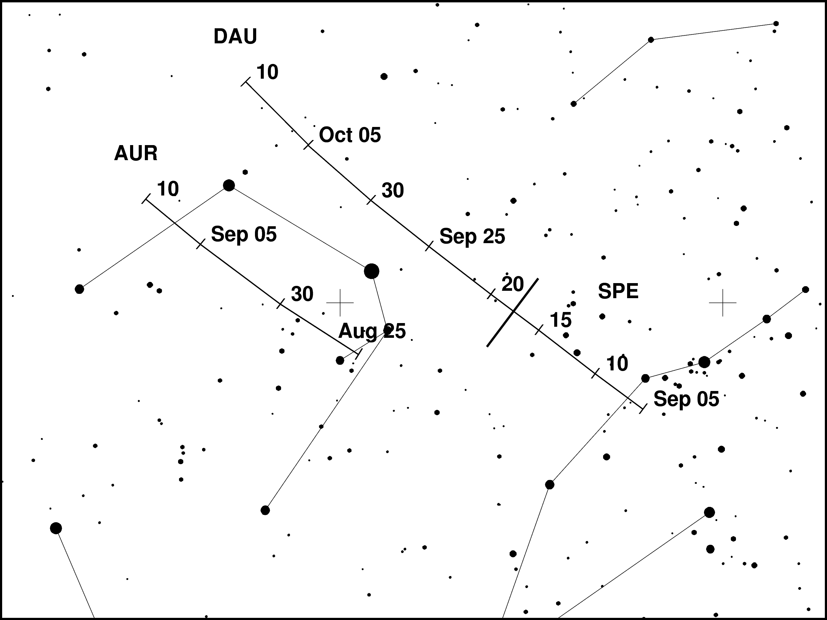

Along with the September Perseids (SPE), these essentially northern hemisphere showers appear to be part of a series of poorly-observed sources with radiants around Aries, Perseus, Cassiopeia and Auriga, active from late August into October. IMO investigations using data collected since 1986 have suggested there are at least three showers which repeat annually, of which the AUR are the marginally stronger. Telescopic data to examine all the radiants in this region of sky - and possibly observe the telescopic β-Cassiopeids simultaneously - would be especially valuable, but still-imaging, video records and visual plotting would be welcomed too.
The AUR have produced short, unexpected outbursts at times, with EZHRs of ~ 30-40 recorded in 1935, 1986 and 1994, although they have not been monitored regularly until very recently, so other events may have been missed. Only three watchers in total covered the 1986 and 1994 outbursts, for instance! While badly moonlit, the first predicted outburst happened roughly as expected in 2007, producing short-lived EZHRs of ~ 130 for western North America, with many bright meteors. Radio data suggested there was a 'tail' to that event where more faint meteors continued for maybe an hour after the strongest peak, but visual observers could not confirm this, pobably due to the moonlit sky. Both Aurigid radiants reach useful elevations after 23h-0h local time, and this year conditions are reasonably good for the AUR peak, with the waxing gibbous Moon setting between midnight and 2h on August 31-September 1. No predictions for stronger activity had been made when this text was written, however.
The DAU name has recently been adopted for the weaker segment of what may be a single shower, as its radiant and activity follow along directly from those of the September Perseids. At present, the showers should be treated as distinct in your observations. The DAU seem to give a weak and very ill-defined maximum between roughly λo = 181°-191° (2009 September 24 to October 4). September 29 is simply the approximate middle of this peak interval, with a waxing gibbous Moon this year that will set before local midnight north of the equator. The later part of this possible maximum spell will see increasing moonlight problems as full Moon approaches on October 4.

As August draws to a close, some α Aurigids (AUR) may be spotted, as they probably begin around August 25, lasting into early September. Their activity is from one of a number of known or suspected radiants around Auriga, Cassiopeia, Perseus, Aries and Triangulum during the early autumn, and is probably the annually strongest. The whole series of showers is currently undergoing detailed investigation, after recent IMO video data revealed a number of significant anomalies to the previously-detected sources here, including the September Perseids (SPE) and δ Aurigids (DAU), neither of which is believed active before early September (all three radiants are shown on the accompanying sky map). At least five different near-Auriga showers have been suggested in late August to mid October by the video results, and it is possible none of the radiant positions currently assumed are correct. The α Aurigid maximum seems to fall around August 31 to September 1, producing ZHRs of ~7. The peak is most likely on the latter date this year, with a waxing gibbous Moon setting between 01h and 02h UT for the UK, quite good news, as the radiant area is usefully-observable only after 23h UT. Unexpected α Aurigid outbursts occurred in 1935, 1986 and 1994, which produced ZHRs of ~30-40, though none of these was widely-seen, while the first predicted outburst was seen in moonlit skies in 2007, yielding estimated ZHRs of ~130 briefly. α Aurigid meteors are swift, like the Perseids, but not usually so bright, though the 2007 event was rich in fireballs.
