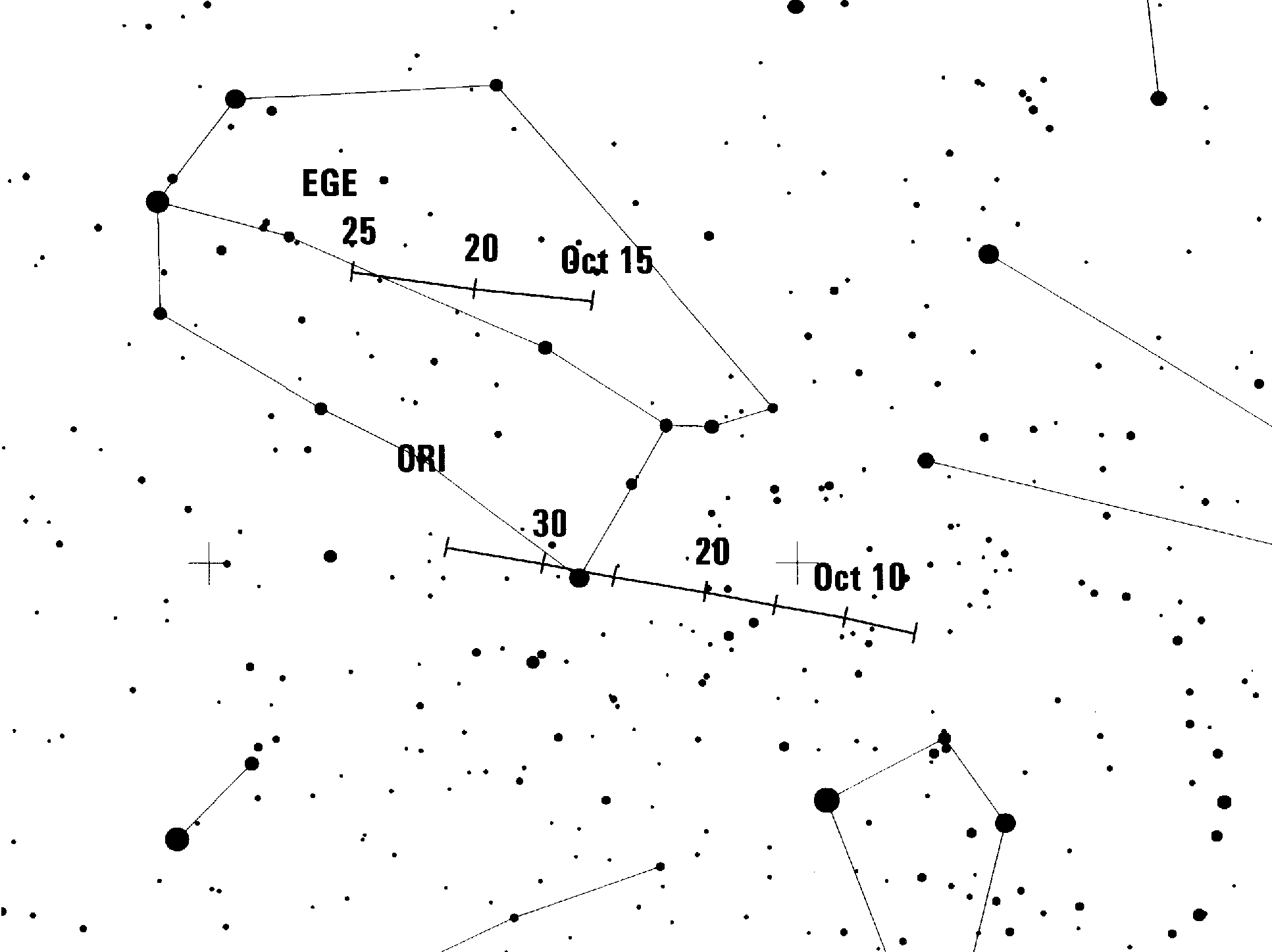

Active: October 14-27
Maximum: October 18 (λo = 205°)
ZHR = 2
Radiant: α = 102° δ = +27°
Radiant drift: see Table 6
v∞ = 70 km/s; r = 3.0
TFC: α = 090° δ = +20° and α = 125° δ = +20° (β > 20° S
A minor shower with characteristics and activity nearly coincident with the Orionids, so great care must be taken to separate the two sources by instrumental techniques - especially video or telescopic work - or visual plotting. While it was suspected that the shower's activity had been overestimated due to misaligned Orionids, a recent video investigation by Sirko Molau did find distinct activity from this source. New Moon creates perfect observing circumstances, an ideal opportunity to obtain more data on them from either hemisphere, though northern observers have a radiant elevation advantage thanks to an area of sky that can be usefully accessed from about midnight onwards.

Observing
The duration of this meteor shower extends from October 10 to 27, with a maximum of 1-2 meteors per hour occurring on October 19 (λ=206°), from α=103°, δ=+25°. The radiant's daily motion is +0.7° in α and -0.1° in δ.

ε-Geminids (EGE)
