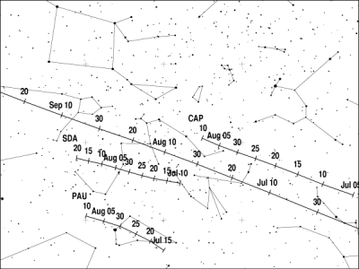

Active: July 15 — August 10; Maximum: July 27 (λ⊙ = 125°); ZHR = 5;
Radiant: α = 341°, δ = −30°; Radiant drift: see Table 6;
V∞ = 35 km/s; r = 3.2;
TFC: α = 255° to 0°, δ = 0° to +15°, choose pairs separated by about 30° in α (β < 30° N).
Very little information has been collected on the PAU in recent decades, so the details on the shower are not well-confirmed, and it seems possible the ZHR may be a little optimistic. However, that impression could be due simply to the large amount of northern hemisphere summer data, and the almost complete lack of southern hemisphere winter results, on it. The stream seems to be rich in faint meteors, rather like the nearby ANT and SDA, so telescopic and video work is advisable to try to establish more about it. Although there is a waxing gibbous Moon for the probable maximum, it will set between local midnight and 1 a.m., while the PAU radiant is available virtually all night, especially from mid-southern latitudes.
Η Piscis Austrinids είναι μια βροχή για την οποία ξέρουμε πολύ λίγα πράγματα. Στο μέγιστο η συχνότητα φτάνει τους 5 διάττοντες/ώρα αν και είναι λίγο αισιόδοξο όπως αναφέρεται παραπάνω. Η σελήνη στο μέγιστο της βροχής δύει γύρω στις 1:30 οπότε αξίζει μια παρατήρηση τις πρώτες πρωινές ώρες παρά το φτωχό αριθμό διαττόντων ανά ώρα.
