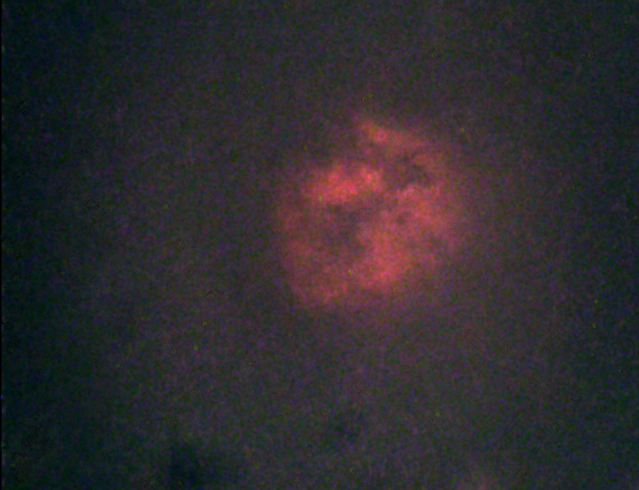

COCOON STARLESS

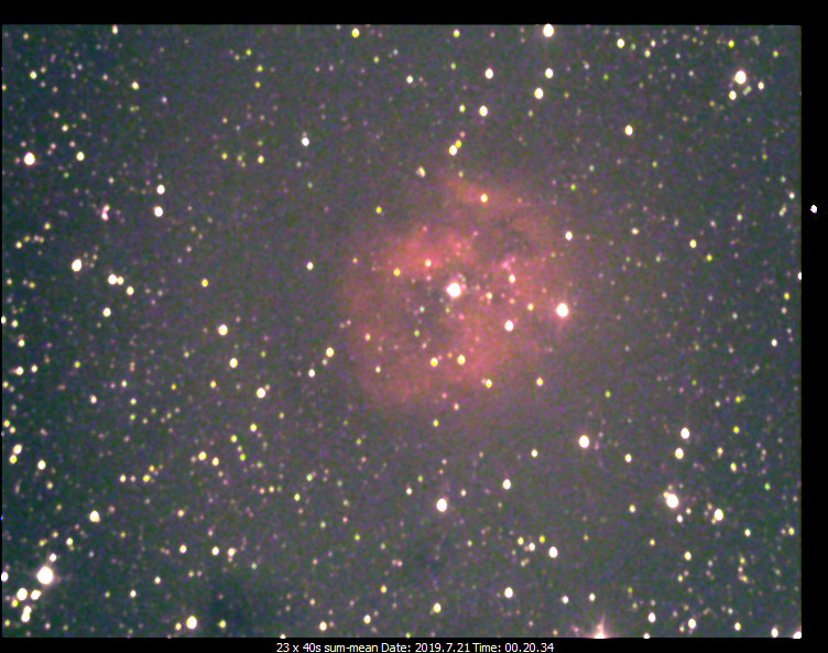

COCOON

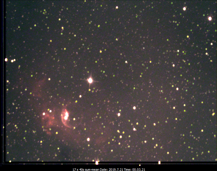

BUBBLE NEBULA STARLESS
BUBBLE NEBULA

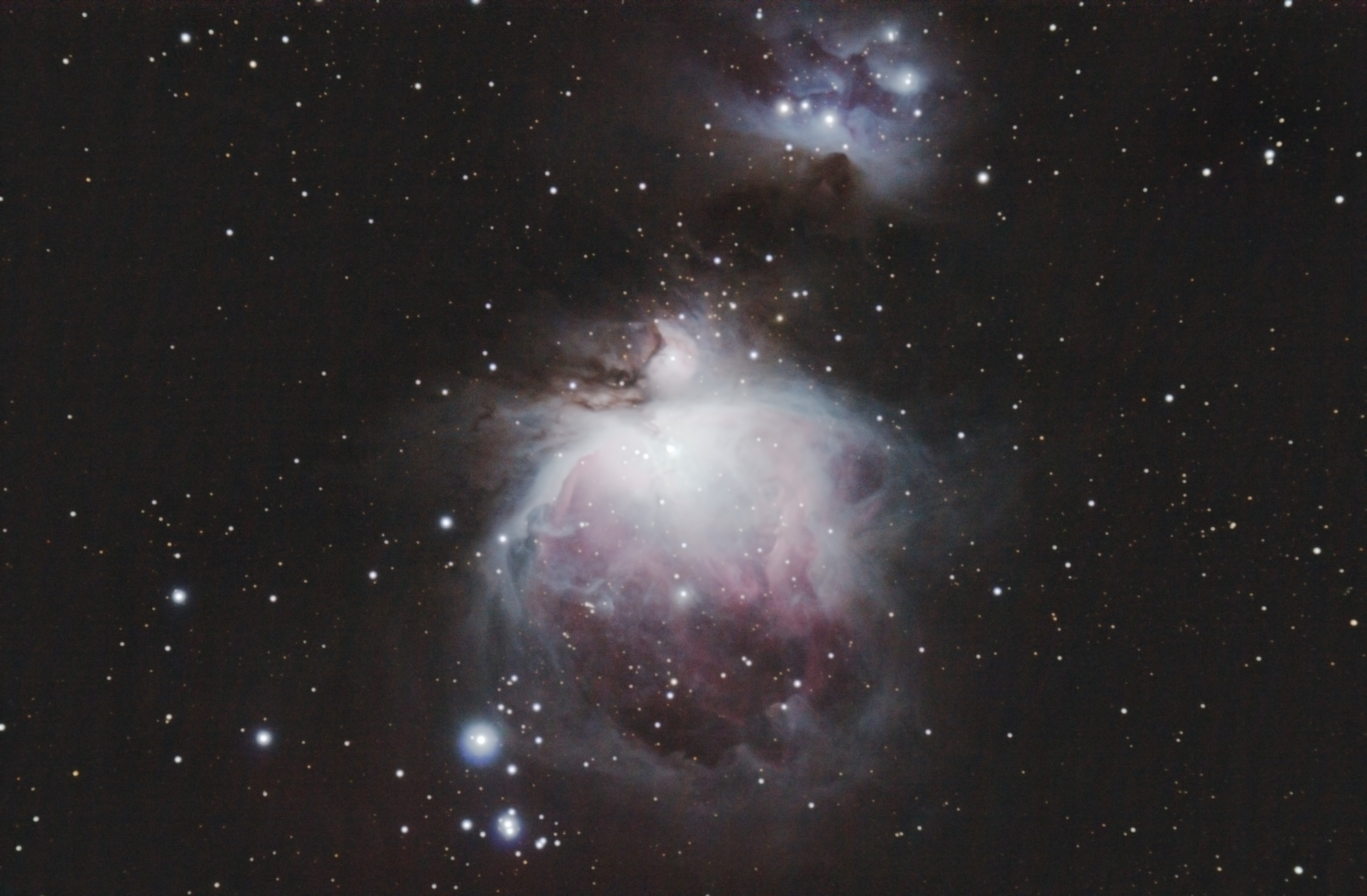

M42 STARLESS
M42

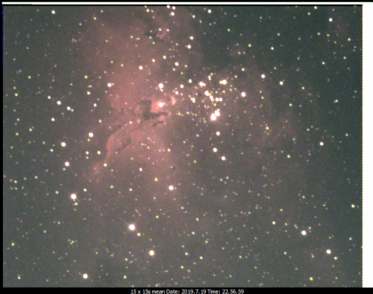

M16 STARLESS
M16
