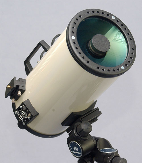

MARINOS Δημοσιεύτηκε Μάρτιος 24, 2006 Δημοσιεύτηκε Μάρτιος 24, 2006 INTES MICRO ALTER M 500 - 5"F/10 Maksutov CassegrainOn Bottomside the scope comes with same base as INTES scopes which offers a central thread 3/8" and 2 outer threads 1/4"-20 with 35 mm spacing. Delivered with order:• optical tube• large 50mm finderbracket for japanese finders• 2" Stardiagonal Deluxe with 96% reflection coating• Adapter 2"/1.25"• 1.25" Barlowlens 2.4x power• 12mm 70° Eyepiece• telecompressor 0.60x• piggy back camera mount• 12 Volt cooling fan at side of tube with APM Poti speedcontroller• paddet transporting case• inside baffling• ZygotestreportTechnical Datas:• Aperture: 127mm• Focal length: 1270mm• F-ratio: f/10 • Magnification: 21x - 300x• Colour: white cream• Glass sort: Pyrex• Weight: 3,3kg = 7.26 lbs• Angular field: 1°45• Tube length: 345mm = 13,58 inch• Optical Design: Maksutov-Cassegrain• Tube diameter: 158mm = 6.22 inch• Finder: 50mm Japan Sucher (optional)• secondary diameter incl. baffle: 42 mm• central obstruction incl. secondary baffle: 33 %• Reflection of mirrors: 95 %• minimum quality for the system: 1/5~1/6 wavefront p.t.v. Χρήστος Μαρινός
