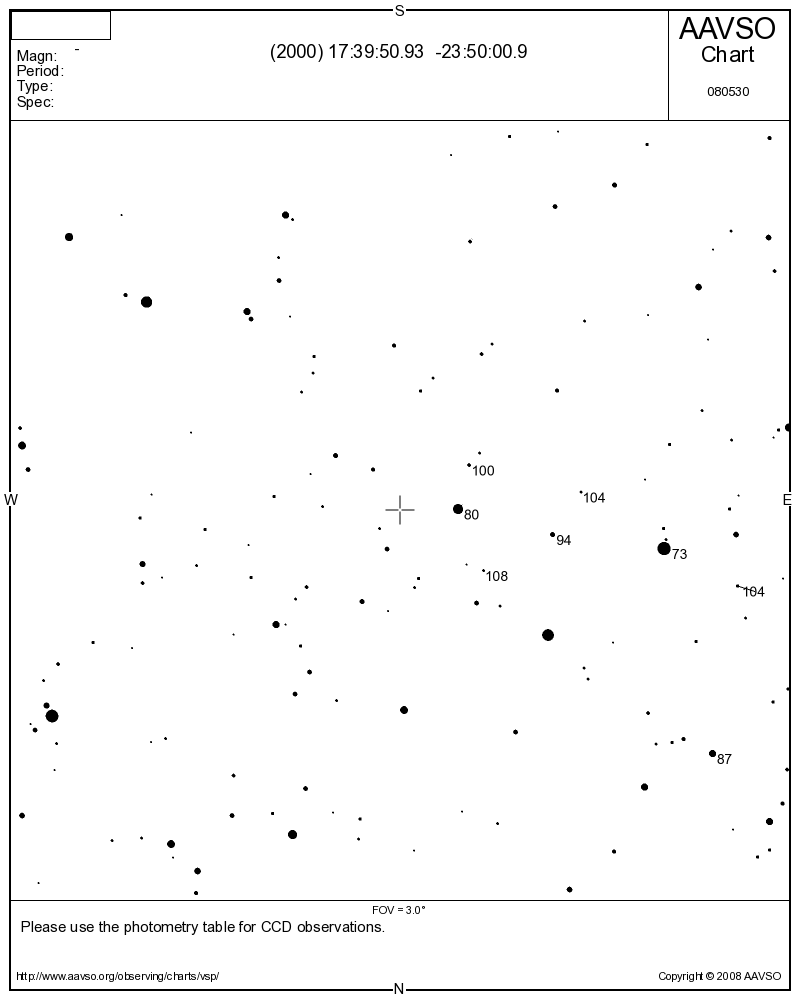

Position: R.A. = 17h 39m 50.93s ; Decl. = -23o 50' 00.9" (J2000)
by K. Nishiyama and F. Kabashima
Charts: Finder charts for this object may be plotted by entering the
coordinates above into VSP: http://www.aavso.org/observing/charts/vsp/
There are a few existing comparison stars to the southeast of the
variable on a C-scale chart; more comparison stars will be added as
soon as a sequence has become available.

Εδώ και ο χάρτης της περιοχής
