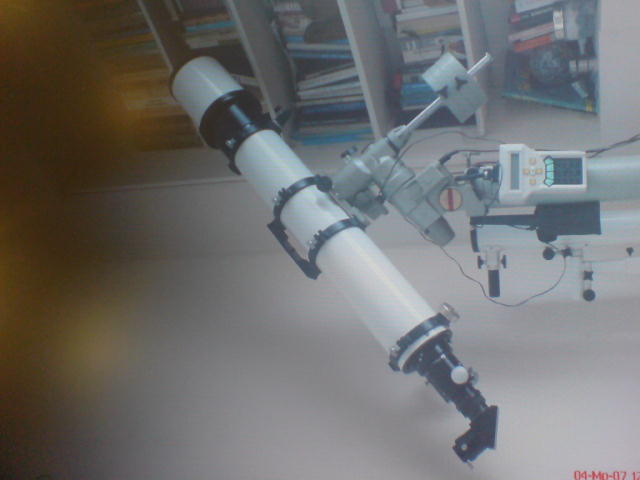

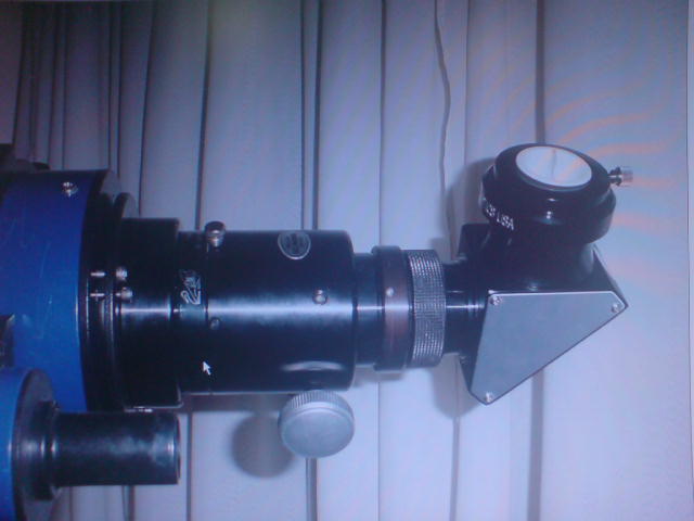

DBAROUNIS Δημοσιεύτηκε Ιούλιος 9, 2008 Δημοσιεύτηκε Ιούλιος 9, 2008 Γεια σας, χρησιμοποιω ενα διοπτρικο 152 f/8 με custom RR objective σε συνδυασμο με chromacor 2. Αποτελεσμα: σφαιρικο σφαλμα περιπου 1/32 και χρωματικο μηδεν. Δειτε τις φωτογραφιες κατωτερω.Για την ευθυγραμμιση των οπτικων ο wo focuser προσαρμοστηκε και ρυθμιζομενη push pull βαση. Η ευθυγραμμιση γινεται με ενα απλο chesire ή/και laser collimator.Σημειωση. Το τηλεσκοπιο δεν πωλειται!!! ΤΙ ΕΙΝΑΙ ΑΠΟΧΡΩΜΑΤΙΚΟ??? (ΤΗΟΜΑS BACK OF TMB OPTICS)With the proliferation of apochromatic refractors that are available to the amateur astronomer, it is time to define the parameters of a true apochromatic objective lens. The modern definition of "apochromat" is the following: An objective in which the wave aberrations do not exceed 1/4 wave optical path difference (OPD) in the spectral range from C (6563A - red) to F (4861A - blue), while the g wavelength (4358A - violet) is 1/2 wave OPD or better, has three widely spaced zero color crossings and is corrected for coma. Here is a more detailed analysis for those that are interested. The term "Apochromat" is loosely used by many manufacturers and amateurs astronomers. Let's look at the history of the definition, and maybe a more modern one. Ernst Abbe, in 1875, met and worked for Carl Zeiss, a small microscope, magnifier and optical accessory company. They realized that they needed to find improved glass types, if they were going to make progress with the optical microscope. In 1879, Abbe met Otto Schott. Together they introduce the first abnormal dispersion glasses under the name of Schott and Sons. Abbe discovered that by using optically clear, polished natural fluorite, in a microscope objective, that apochromatism could be achieved. These first true apochromatic microscope objectives were so superior to the competition, that Zeiss gained nearly the entire high end market. So secret was the use of fluorite, that Abbe marked an "X" on the data sheet for the fluorite element, so as to keep it secret from the other optical companies. Abbe's definition of apochromatism was the following. Apochromat: an objective corrected parfocally for three widely spaced wavelengths and corrected for spherical aberration and coma for two widely separated wavelengths. This definition is not as simple as it sounds. I have designed thousands of lenses: simple achromats, complex achromats, semi-apos, apochromats, super-achromats, hyper-achromats, and Baker super-apochromats. Abbe's definition, to put it in clearer terms (I hope) is that a true apochromat is an objective that has three color crossings that are spaced far apart in the visual spectrum (~4000A, deep violet to ~7000A, deep red). However, just because a lens has three color crossings, doesn't mean that it is well corrected. Let's say that a 4" lens has three color crossings at the F, e and C wavelengths (4861A, 5461A and 6563A). Fine, this objective is now considered an apochromat by most amateurs and even optical designers because it has three color crossings in the blue, green and red -- the common definition of an apochromat. But what about the levels of spherical aberration at each of these wavelengths? If the lens is 2 waves overcorrected at 4861A, and 1.5 waves undercorrected at 6563A, is it still an apochromat? No. It is no better than an achromat, as the OPD wavefront error is worse than a 4" f/15 achromat. Abbe, in his definition of apochromat, states that spherical aberration must be corrected for two widely spaced wavelengths. Now I will tell you what happens when you correct spherical for two widely spaced wavelengths: you correct for all the wavelengths between them too. This is called correcting for spherochromatism (the variation of spherical aberration with a change in wavelength). Only with extremely long focal lengths, advanced Petzval designs, aspherics, large air spaces, or a combination of these designs/factors, can you correct for this aberration. It is the designer that must come up with a good compromise of color correction, lack of spherical aberration (3rd order and zonal) and controlling spherochromatism, so as not to degrade the image contrast.

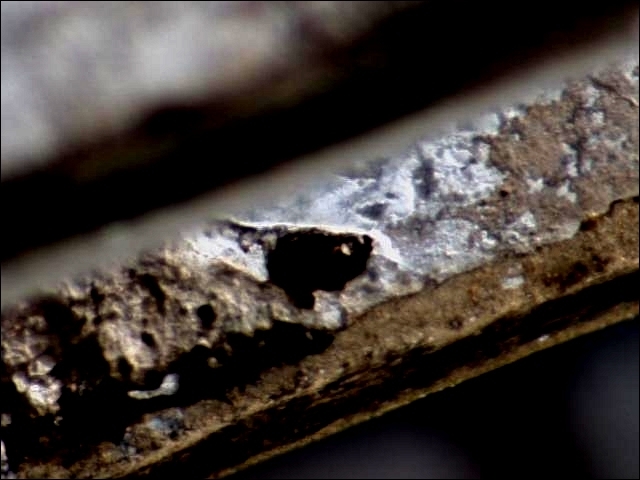

DBAROUNIS Δημοσιεύτηκε Ιούλιος 9, 2008 Δημοσιεύτηκε Ιούλιος 9, 2008 Δειτε τυπικη αναλυση και αντιθεση (τσιμεντο σε 800 μετρα)

DBAROUNIS Δημοσιεύτηκε Ιούλιος 9, 2008 Δημοσιεύτηκε Ιούλιος 9, 2008 Απο πανω προς τα κατω αχρωματικοed αχρωματικοchromacor Ichromacor II
DBAROUNIS Δημοσιεύτηκε Ιούλιος 9, 2008 Δημοσιεύτηκε Ιούλιος 9, 2008 Η SYNTA δεν παρεχει κατι αντιστοιχο μια που η συνθεση των κρυσταλλων του chromacor (3 τον αριθμο) ειναι custom απο ARIES και δεν ειναι διαθεσιμη μαζικα. Οπως και το neoachromat Vixen υπαρχει ενας - δυο φακοι στον εστιαστη κατα την αρχη Petzval που παρεχουν ευθυ πεδιο χωρις να επανεστιαζουν το ερυθρο-ιωδες-κυανο της χρωματικής εκτροπης. Δειτε στη σελιδα της ΑΚΤΙΣ για το chromacor τις φωτο μου της σεληνης σε B, R, G. To καναλι Β ειναι εστιασμενο κανονικα. Εκτος της ARIES κατι αντιστοιχο κατασκευασε η ASTROPHYSICS τη δεκαετια του 80 για 2 διοπρικα εννεα ιντσων, ενω στην ιδια αρχη βασιζεται και το διοπτρικο PLOESSL του αστεροσκοπειου της Αθηνας (κατασκευη 1846!!). Ο PLOESSL κατα σκευασε αποκλειστικα τετοια τηλεσκοπια. Διαβαστε σχετικα στο HISTORY OF THE TELESCOPE-HENRY KING-DOVER PUBLICATIONS (ΣΕΛ 191). Παρομοια αρχη εχουν και τα Shupmann Telescopes (με χρηση ομως mangin mirror σαν τα Klevtzov Vixen VMC). Στο συστημα μου η εθυγραμμιση ειναι εξαιρετικα απλη και χωρις προβληματα στις μετακινησεις. Θα χαρω να δωσω οποια αλλη πληροφορία. Το βασικο χαρακτηριστικο είναι η πληρης εστιαση ολων των χρωματων και οχι η αποκοπη τους οπως γινεται με τη χρηση φιλτρων. Επιπλεον το σφαιρικο σφαλμα εκμηδενιζεται οπως και το σφαιροχρωματικο (μεταβολη της σφαιρικης εκτροπης σε συναρτηση του μηκους κυματος). Αποτελεσμα η τελεια λειτουργεια ακομα και σε "ατοπες" μεγενθυσεις 150χ/ιντσα!!! πραγμα που χρησιμοποιω μονο σε δοκιμες. Σχετικα με το ED δειτε τα spot diagrams πιο πανω. Διαβαστε http://www.cloudynights.com/item.php?item_id=18 Δειτε το συστημα εστιασης και τον αντικειμενικο RR. Το διαγωνιο που ενσωματωνει το συστημα ειναι INTES DELUXE και οχι WO, το οποιου το κατοπτρο εχει επιστρωση HILUX ORION OPTICS (UK),ενω το σφιξιμο γινεται με APM SELF CENTERING ADAPTER και οχι με απλη βιδα που δεν παρεχει ομοιομορφη πιεση. Αντιστοιχο συστημα εχουν και οι εστιαστες FeatherTouch στα αποχρωματικά TEC.Τα κλασσικα ορθοσκοπικα KASAI και BAADER λειτουργουν θαυμασια με το συστημα οπως επισης και ο KLEE 2.8x Barlow. Web cams και CCD οπως το ΜΧ516 ειναι τελεια στη χρηση με το συστημα αυτο. Επισης και SLR φωτο είναι εξαιρετικα εύκολο να παρθουν. Η ARIES συντομα θα παρουσιασει αποχρωματικα νεας γενεας με αντικειμενικους με ή χωρις chromacor και για το λογο αυτο η παραchromacorγωγη chromacor εχει μειωθει δραστικα. Παρ΄'ολα αυτα στο astromart το chromacor παραμενει very hot item.

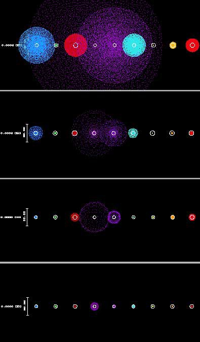

DBAROUNIS Δημοσιεύτηκε Ιούλιος 9, 2008 Δημοσιεύτηκε Ιούλιος 9, 2008 οντως ενα καλα σεταρισμενο αχρωματικο με chr2 ειναι καλυτερο απο ed.Δωστε εμφαση στο κειμενο το Τ. Back που παραθετω καθως και στα spots diagrams, λογω καλυτερης διορθωσης σφαιρικου, χρωμοσφαιρικου και χρωματικου σφαλματος. Το chr2 κοστιζει usd 750 περιπου αλλα πλεον ειναι δυσευρετο. Επισης υπαρχουν διαβαθμισεις στη σφaιρικη διορθωση που προσφερει, για αυτο πρεπει το σφαιρικο σφαλμα του αντικειμενικου να ειναι γνωστο με ακριβεια. Επισης ο αντικειμενικος δεν πρεπει να εχει κομη, αστιγματισμο και ζωνες σφαλματα που δεν διορθωνονται. Για το λογω αυτο επελεξα φακο RR και οχι Synta. Δειτε την οπτικη αναλυση του αντικειμενικου φακου μου στο αρχειο PDF. Το αρχικο strehl ειναι παρα πολυ καλο (0.95 περιπου) ενω υπαρχει σφαιρικο undercorrection 1/6. To chr2 εχει overcorrection 1/6 οποτε το συνολικο σφαιρικο σφαλμα ειναι μηδεν. Σημαντικος ειναι ο εστιαστης οπου παλι το Synta υστερει. Δειτε το συστημα μου, οπου το θεμα της ευθυγραμμισης λυνεται απλουστατα.Για την πλειονοτητα των χρησεων ενα τετοιο συστημα παραμενει εξαιρετικα ανταγωνιστικο εναντι των κλασσικων αποχρωματικών. Στο χωρο της αστρονομιας ειμαι απο το 1981, με πλειαδα τηλεσκοπιων ενω σε σπουδες ειμαι μαθηματικος με τομεα ουρανια μηχανικη αν και εργαζομαι στο χωρο των επενδυσεων.SCANNER.pdf
