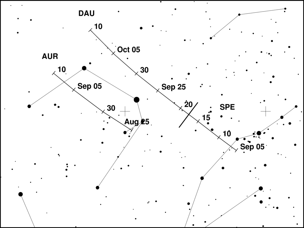

Active: September 18-October 10
Maximum: September 29 (λo = 186°) but see text
ZHR = 3
Radiant: α = 82° δ = +49°
Radiant drift: see Table 6
v∞ = 64 km/s; r = 2.9
TFC: As AUR
