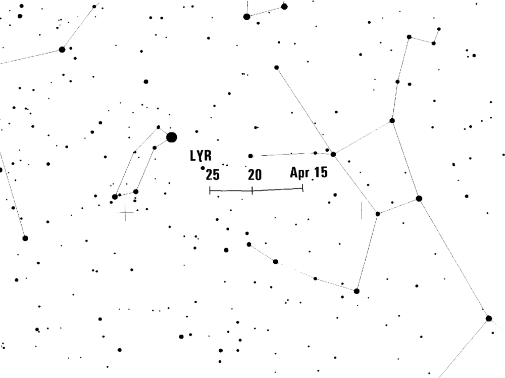

Bi2L Δημοσιεύτηκε Απρίλιος 8, 2010 Δημοσιεύτηκε Απρίλιος 8, 2010 Lyrids (LYR)πηγη imo.nethttp://www.imo.net/calendar/2010#lyrActive: April 16–25; Maximum: April 22, 17h UT (λo = 32 .◦32, but may vary - see text);ZHR = 18 (can be variable, up to 90);Radiant: α = 271◦, δ = +34◦; Radiant drift: see Table 6;V∞ = 49 km/s; r = 2.1;TFC: α = 262◦, δ = +16◦ and α = 282◦, δ = +19◦(β > 10◦ S). The λo = 32 .◦32 timing given above is the ‘ideal’ maximum found in the most detailed examination of the Lyrids in modern times, published in 2001 by Audrius Dubietis and Rainer Arlt, drawing on IMO results from 1988–2000. However, the maximum time was found to be variable from year to year between λo = 32 .◦0–32 .◦45 (equivalent to 2010 April 22, 09h15m to 20h20m UT). Activity was discovered to be variable too. A peak at the ideal time produced the highest ZHRs, ∼ 23, while the further the peak happened from this, the lower the ZHRs were, down to ∼ 14. (The last very high maximum occurred outside the examined interval, in 1982 over the USA, when a short-lived ZHR of 90 was recorded.) The mean peak ZHR was 18 over the thirteen years examined. While generally thought of as having a short, quite sharp, maximum, this latest work revealed the shower’s peak length was inconstant too. Using the interval that ZHRs were above half the maximum amount, the Full-Width-Half-Maximum time, a variation of from 14.8 hours (in 1993) to 61.7 hours (in 2000) was detected, with a mean value of 32.1 hours. The very best rates are normally achieved for just a few hours even so. One other aspect of the analysis confirmed data from earlier in the 20th century, that occasionally, as their highest rates occurred, the Lyrids produced a short-lived increase in fainter meteors. Overall, the unpredictability of the shower in any given year always makes the Lyrids worth watching, since we cannot say when the next unusual return may take place. Lyrids are best viewed from the northern hemisphere, but they are visible from many sites north and south of the equator, and the shower is suitable for all forms of observation. As its radiant rises during the night, watches can be carried out usefully from about 22h30m local time onwards from mid-northern sites, but only well after midnight from the mid-southern hemisphere. On April 22, the waxing gibbous Moon will set between 1 and 2 a.m. for most northern sites (the later times fall further north), leaving at least a short while before morning twilight begins with the radiant at a healthy elevation for dark-sky observing. If the ideal maximum time recurs, it should be best-seen from sites across the eastern half of Asia, but, as already noted, other maximum times are perfectly possible. πηγη popastro.comhttp://www.popastro.com/sections/meteor/meteor-apr2010.htmApril 2010 As spring starts to quicken everything into life again, even in the more northerly parts of Britain during April, so meteor activity begins to pick up too, with slowly improving sporadic rates. The first northern shower of any note since the Moon-affected Quadrantids of January, the Lyrids, unfortunately also has a problematic bright Moon this year. However, like February-March, April has something of a reputation for producing more than its share of sporadic fireballs, even if some of this impression may result from the occasional spectacular Lyrid fireball. Shower of the Month: The Lyrids Lyrid meteors can be seen from April 16-25. The shower should peak on April 22, probably sometime between 09h-21h UT, mostly in UK daytime regrettably, and with a waxing gibbous Moon that sets so late, it leaves almost no twilight-free observing time even from southern Britain then, and none at all further north. Even UK radio-meteor observers will likely struggle to follow what happens if this timing proves correct, as the radiant remains properly observable that way just till late morning, and rises to a usable elevation again, including for visual observers, only after 22h30m UT or so. It culminates around 04h. As the chart here shows, for the peak, the radiant is about a Lyre's length (the distance from α Lyrae (Vega) to γ Lyrae) south-west of Vega, and actually in Hercules, not nearly so close to Vega as some people expect. As with all the radiant drift sketch maps used in these notes, that for the Lyrids is suitable for use with a dim red light once printed-out, and only selected brighter stars and constellation link-lines are given, enough to help find the radiant in the sky. The interval for the shower's peak timing is based on the most recent detailed analysis of International Meteor Organization (IMO) data. The closer it falls to ~17h UT within that range on April 22 in 2010, the higher its Zenithal Hourly Rates (ZHRs) are likely to be, perhaps 20-25 or more. The average ZHR is 18, and tends to be lower the further the maximum happens away from this "ideal" time. In general, the peak is usually quite short, lasting no more than a few hours, but occasionally more prolonged maxima, lasting for 8+ hours have been seen, recently in 2000 and 2001, and rare strong ZHRs of up to 90 (last in 1982 over the USA) may occur too. Thus in years with little or no Moon, the shower is always one to watch. Lyrids are medium-fast meteors, and can be very bright sometimes. πηγη meteorshowersonline.comhttp://meteorshowersonline.com/lyrids.html Observing the Lyrids For a short summary of this meteor shower, click hereThe Lyrid meteor shower is not one of the strongest of the annual meteor showers, but it can be enjoyable to those meteor observers thirsting for something after over three and a half months of weak meteor activity. The Lyrids generally begin on April 16 and end on April 26, with maximum generally occurring during the night of April 21/22. At maximum, hourly rates can reach about 10 meteors per hour. The Lyrids are particularly interesting for two reason. First, observations have been identified back to at least 2600 years, which is longer than any other meteor shower. Second, the meteor shower occasionally experiences an outburst of about 100 meteors per hour and the reason is basically unknown. There are other, weaker meteor showers going on around the same time as the Lyrids. The Lyrids move rather fast. When you see a meteor, mentally trace it backwards. If you end up at the constellation Lyra then you have probably seen a Lyrid meteor! If you are not sure where Lyra is in the sky, the following charts will help you find it from both the Northern Hemisphere and Southern Hemisphere:http://www.astrovox.gr/forum/download.php?id=12521 History During the infancy of meteor astronomy, a number of interesting meteor showers were generally overlooked. One of these was the Lyrids. Following the discovery that the Leonid meteor shower was an annual display, Dominique Francois Jean Arago did some research in 1835 and found enough evidence to support the existence of a probable annual meteor shower around April 22. Responding to this suggestion was Edward C. Herrick (New Haven, Connecticut, USA), who carried out coordinated observations of this meteor shower with Francis Bailey in 1839. These observations revealed weak, but definite activity, which seemed to peak on April 19. Herrick then began scouring the literature and quickly uncovered a large display of meteors that was seen by numerous people in the eastern part of the United States on April 19-20, 1803. He also identified probable observations of this meteor shower from the years 1095, 1096, and 1122. Despite Herrick's observations and historical evidence supporting this stream's existence, the next coordinated observations were not carried out until 1864, when Alexander Stewart Herschel observed several meteors from the region of the constellation Lyra on the night of April 19/20. During 1866, the annual Perseid shower had been linked to periodic comet Swift-Tuttle and the Leonids were linked to the newly discovered periodic comet Tempel-Tuttle. As 1867 began, astronomers were still busy seeking further evidence linking meteor showers to comets. Edmond Weiss (Vienna, Austria) was busy calculating probable close encounters between Earth and comet orbits. One comet orbit, that of Thatcher (1861 I), was found to come within 0.002 AU of Earth's orbit on April 20. As Weiss searched through various publications for evidence of this shower's presence, he came across several references to observed showers around April 20. Later that same year, Johann Gottfried Galle mathematically confirmed the link between comet Thatcher and the Lyrids and successfully traced the history of the shower back to March 16, 687 BC. The peak rates of activity have remained relatively consistent from year to year with values generally between 5 and 10 per hour, although there have been unexpected outbursts. As noted earlier, a very strong outburst was noted in 1803. William F. Denning (England) pointed out that in 1849 and 1850, observers in New Haven and India, respectively, noticed "unusual numbers" of meteors on April 20. Denning himself observed a maximum hourly rate of 22 during his observations of 1884, H. N. Russell (Greece) found a rate of 96 on April 21, 1922, Koziro Komaki (Nippon Meteor Society, Japan) saw 112 meteors (most were Lyrids) in 67 minutes on April 22, 1945, and several observers in Florida and Colorado noted rates of 90-100 on April 22, 1982. The duration of this shower is fairly short. Four amateur astronomers from southern California (Alan Devault, Terry Heil, Greg Wetter and Bob Fischer) observed the Lyrids during April 20 to 24, 1974, and concluded that the shower remained above 1/4 its maximum rate for 3.6 days. Denning reported that his extensive observations of this meteor shower revealed that weak traces of activity were present as early as April 14 and as late as April 26. Interestingly, Zdenek Sekanina reported that the Radio Meteor Project, which spanned the period of 1961-1965, detected probable members of this stream as late as May 3. Several observers have attempted to estimate the orbital period of this meteor stream from the observations above. Herrick concluded from his historical study of Lyrid activity that the stream exhibited an orbital period of 27 years. Based on the activity observed in 1803 and 1850, Denning concluded that the Lyrids had an orbital period of 47 years, but his prediction of possible enhanced activity in 1897 was met by rates not exceeding 6 per hour. After the outburst in 1982, many researchers remarked that the period was about 60 years, based on the showers of 1803, 1922 and 1982. Unfortunately none of these suggested orbital periods fit the observations perfectly, and it might be possible that the Lyrid orbit contains several irregularly spaced knots of material that could make it impossible to arrive at an accurate period based on visual observations. Using the more precise methods of radar and photographic techniques, several attempts have been made to determine the period of the Lyrid stream. A collection of photographic orbits published by Fred L. Whipple in 1952, revealed two "reliable" Lyrid meteors with periods differing by 300 years! In 1971, Bertil-Anders Lindblad published a Lyrid stream orbit, which had a period of 131 years, that was based on 5 meteors photographed during 1952 and 1953, and, in 1970, Sekanina published a Lyrid stream orbit based on radio meteors which had an average period of 9.58 years. The discrepancy in the orbital period of the Lyrids is primarily due to a lack of data. The number of meteors obtained from the major lists of photographic meteors totals 12, with only 6 being considered reliable (and, incidentally, giving a period of 139 years---close to Lindblad's despite sharing only 2 meteors). Comet Thatcher's period of 415 years is probably much more reliable today than the computed orbital period of the Lyrids. The relatively sharp peak of the Lyrids seems to be due to the overall lack of serious planetary perturbations. Observational evidence indicates the stream is at least 2600 years old. Βασίλης ΜεταλληνόςOO 16 1600 f4ΟΟ 12.5 1525 f4.8 NEQ6TOA130 1000 f7.7 ΕΜ200ED80 600 f7.5, Vixen9x63Canon eos 6D, Sony a7s2, Wat120n+,Asi1202009年7月22號日食 - 2017 Aug 21www.metallinos.net

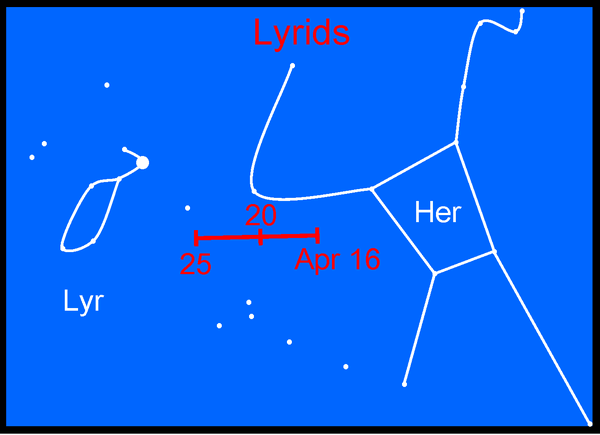

RaQua Δημοσιεύτηκε Απρίλιος 19, 2010 Δημοσιεύτηκε Απρίλιος 19, 2010 Αγαπητοί φίλοι, αν και λίγο καθυστερημένα στέλνω ένα μικρό κειμενάκι [στα ελληνικά!] για του Λυρίδες που έχουν μέγιστο σε 2 μέρες. Δεδομένου της μεταβλητότητάς τους πάντως θα έχει ενδιαφέρον ενώ αποτελεί και μια καλή πρώτη ιδέα για να προετοιμαστούμε για τις επόμενες μέσα στο καλοκαίρι. Όσοι πιστοί προσέλθετε! Φιλικά, Γρηγόρης Μαραβέλιας,ΣΕΑ, ΙΜΟlyrids2010.pdf
