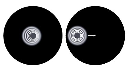

Fred Ley Δημοσιεύτηκε Απρίλιος 25, 2008 Δημοσιεύτηκε Απρίλιος 25, 2008 There is a very nice instructional video on collimating a Newtonian telescope located at http://www.andysshotglass.com/Collimating.htmlI watched the video and found it to be really good. It is in English and I do not know if that will be something to consider. The magnified and out of focus star disks that I mentioned look like this example that I took from another web site in order to show you an example of what I am trying to explain. Like they say "a picture is worth a thousand words". Polaris is a good choice to collimate with as you do not need a clock drive if you have a Dobsonian telescope. Another web site that talks about collimation is located at http://web.telia.com/~u41105032/kolli/kolli.html -Fred The crcles are not concentric in the image on the left. They should look like the image on the right. www.instrumentsoflight.com - www.ras.org.ukwww.avastronomyclub.org - www.aavso.org (LEF)www.imca.cc (#9181)www.alpo-astronomy.orgAstrovox Member #4.Doing astronomy since 1970Sky & Tel subscriber since 1971www.highdeserttelescopes.com
Nisam Δημοσιεύτηκε Απρίλιος 25, 2008 Συγγραφέας Δημοσιεύτηκε Απρίλιος 25, 2008 Dear friend Fred.. final i realize how to make collimation with the help of the other boys, but especial from you. Before one our ago i was looking jupiters rings and i was dont believιng in my eyes how clear and sharpen was the image from looking inside my telescope. Thank you my friend,i realized colimation is a piece of cake. I have one good think.... i learn very quickly.... But my problem was ... i see only jupiter from my home in πειραια and nothing else....!!!!!!! lot of lights lot of fucking lights !!!!!
